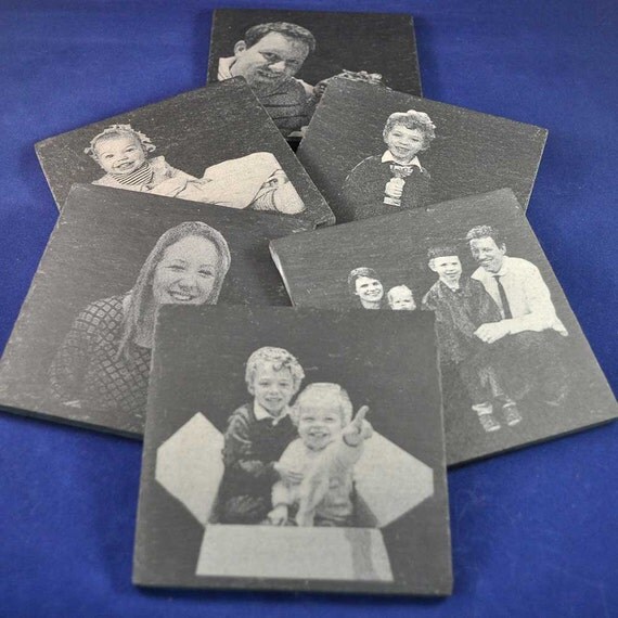

there are lots of paid software titles, (I use photoshop now) but, I used to get perfectly decent photo engraving results using Gimp... there are some great tutorials on YouTube...
Only additional advice is... make sure your scan gap matches your DPI, for example a 300 DPI image should use a scan gap of 0.08466mm
Simple equation... Scan Gap = DPI / 25.4
There is a forum topic somewhere that lists scan gap for common DPI's
Image prepared with Gimp
Image prepared with Photoshop
Good Luck

Re: Newbie on photo engraving
Awesome - Thanks for the advice! Im still struggling to get clear images ... but will keep perservering
looking good, but don't forget that's a negative
thats a great image... as Lightnin said... dont forget to invert the image colours on the Photo...black to white white to black... there is a menu item in Laser script for that...
OMG .. I feel like such an rrrrrs
Did not see that !
Thanks guys :doh: :facepalm: Will try again this weekend!
