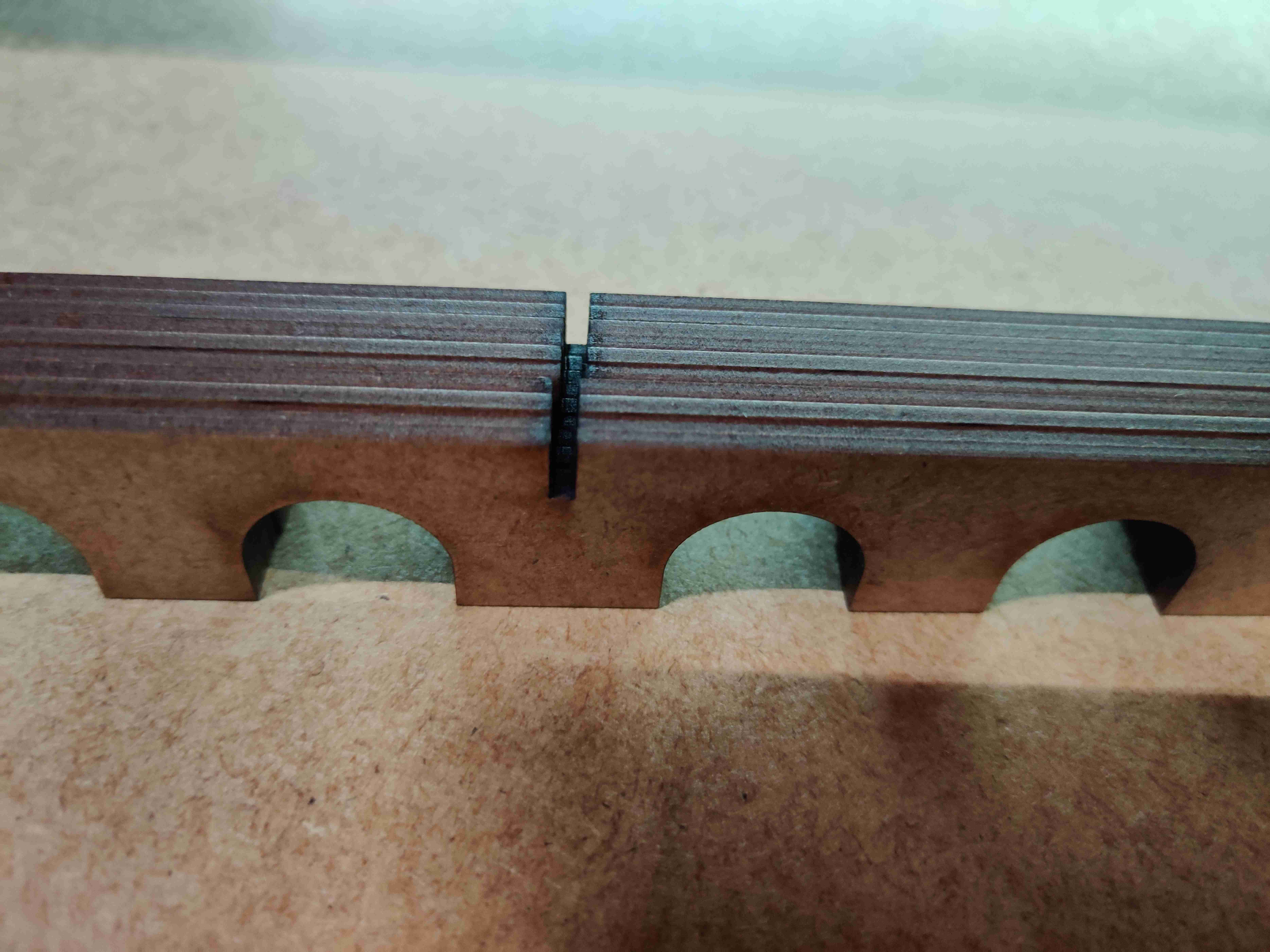

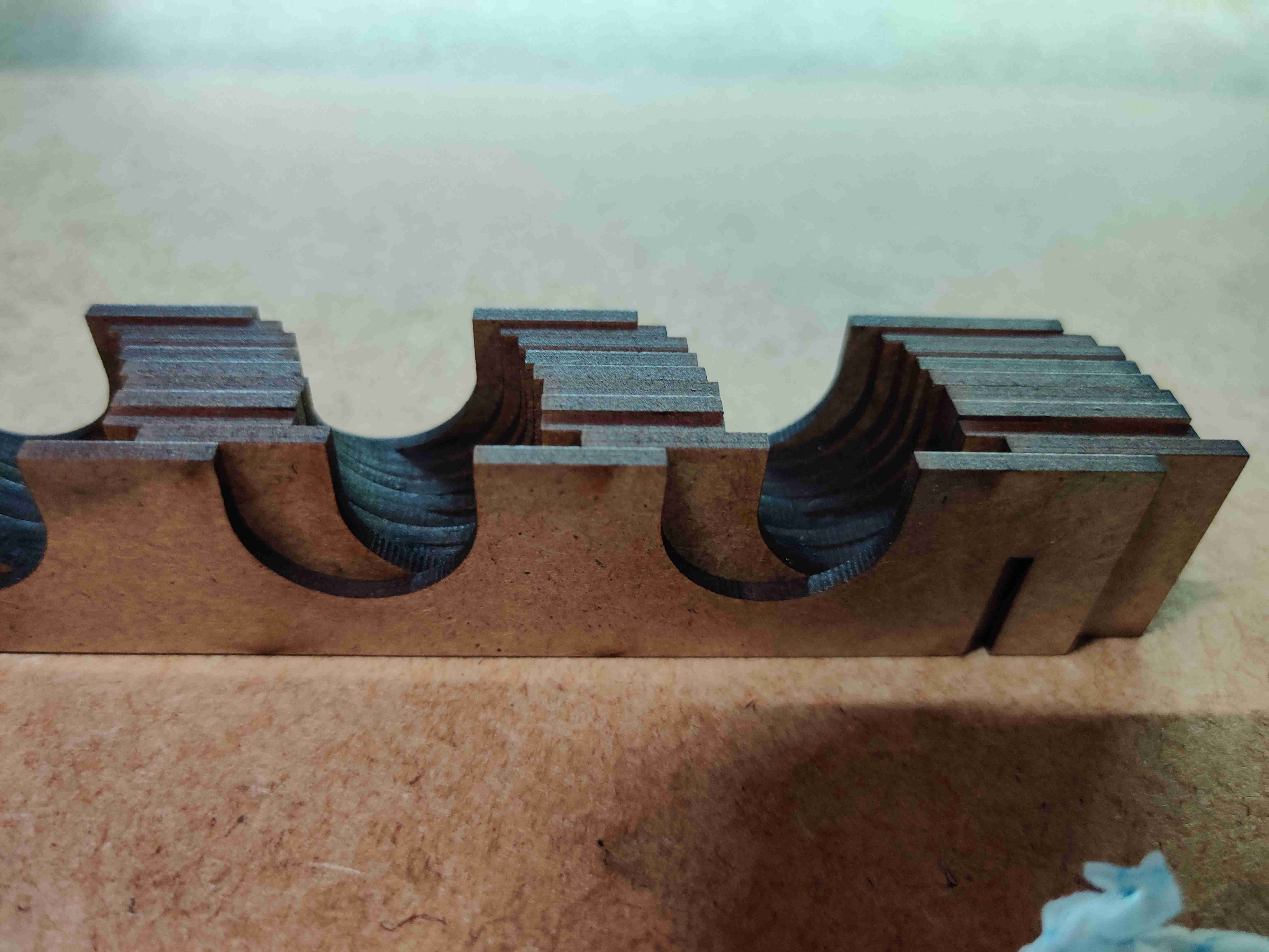

i am have a issue with one of my laser cutter
its cutting parts the wrong size. but its not doing the issue consistently and i have been unable to figure out any pattern to the issue.
i have attached 2 pictures, these parts were cut at the same time in the same origination
the height is all over the place on them, cut in the y axis
and the slots in the center are also not lining up cut in the x axis
this machine has been doing this for a while and has had the following replaced
x + y
Belts
bearings
stepper
x liner bearing
x stepper motor wires
the machine has been cleaned and i have checked the lenses / mirrors are not loose
i have also tried a stepper controller from a good machine to see if that helped to no avail
Any suggestions what else to do please?
ls1290 and lasercut 5.3

i have now also tried a leetro controller board from a different machine and its still doing it with no change

Wwgm
Posts: 5
Joined: Tue Jan 11, 2022 1:37 pm
Contact:
Re: problems with cutting, parts cutting wrong sizes
Post by Wwgm »
Daven wrote: Tue Jun 06, 2023 2:46 pm So is it the same part set up as an array? If you create a simple box and cut that in an array does it do the same?
i'm not sure what you mean by an array
they are parts of a product i sell, its doing it to all the parts not just the ones shown, they were just some of it to show in the post, the larger the part the more its off by.
i have cut out a 100x100mm square and it cut it to 100.06mm in the x and 99.85mm in the y
x seems to cut dimensional accurate parts but slots and cutouts are miss aligned by +/- 0.5mm or so
y seems to be cutting parts at wrong sizes, but its not consistent, some parts are to small some are to large
