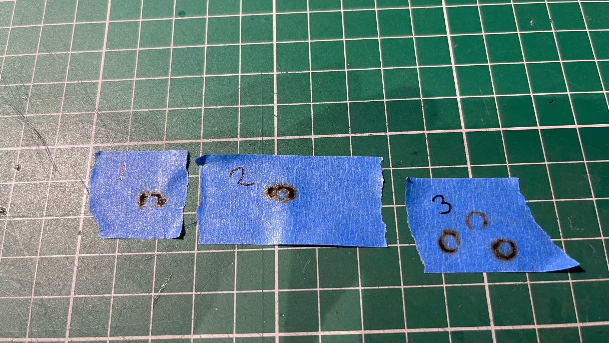

Hi
Using an HPC3020, been cutting fine until today, tried cutting and no power. Checked the alignment, this is the pattern on the 3 mirrors...
Instead of a dot I'm getting a circle...
Anyone got any suggestions??

I had this once and it turned to be the tube.
