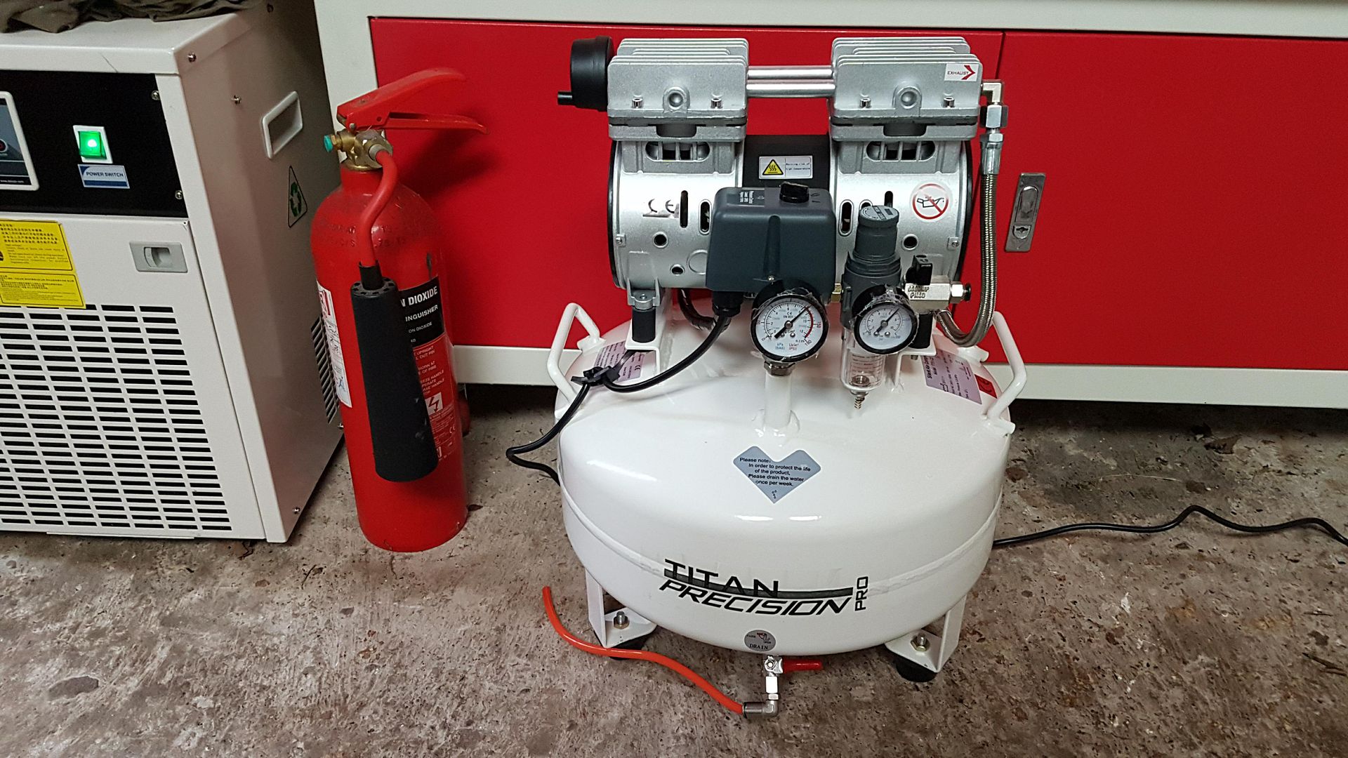

I have the Silent Titan (edited) compressors and they are oil free.
You do not need much more pressure to be honest - but you do need good air flow. Mine run for hours turning on and off - I have tweaked the cut-in and cut-out a bit so they cut-in and out a bit quicker.
They are not silent and about the same as the standard pumps but the fact they switch off at least gives you a break.

Sorry yes it is Titan - I have a 22l and a 30l.
I started with one for both machines but then got the 30l Not much between them to be honest.
Yes the pump runs for say two minutes and then cuts out and then 10 or 15 minutes later comes back on - not timed it so don't hold me to it!
They were being used for 6 hours today and around 7 yesterday! I do shut the valves of if I am fiddling about setting up the next job but sometime don't bother! Definitely recommend them from http://sm-t.co.uk/air-compressors/
I would say that if you have space get the largest reservoir you can afford.

I bought some of the nylon tube (same as the one supplied with the laser to pump) and the push fit valves and joints as I had two machines on one compressor to start with.
Now I have one each connected as a straight swap for the original pump but use push fit valves to adjust the flow for the particular job using the main valve as a main on/off. I leave them pressurised all the time and empty any water every couple of weeks (if I remember
